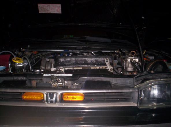

idn who did the swap but it is an obd1. the ecu is original to the car. today when i swapped out the o2 sensor i found something very strange tho. there was two o2 sensors. both before the cat. so just have one hooked up. still seems good.

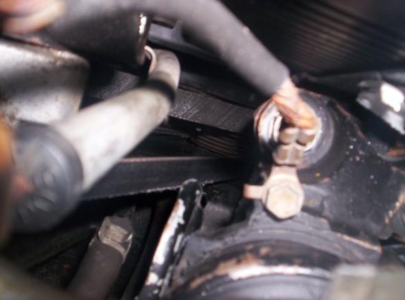

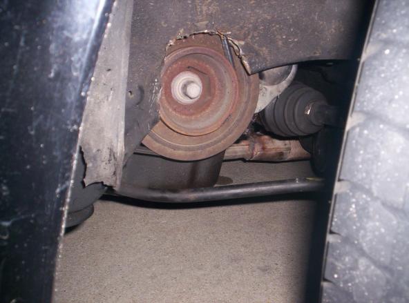

i know for a fact that things arent done correctly. like the driver side motor mount was the original one for the car and was only bolted with one bolt because the mounts holes are too far apart. it cracked so i got the mount for the motor and had to grind it down to the fit in the car, bent my power steering pulley in the process (still needs to be fixed), but got it on then turn the car on and my crank(i think it is) was grinding on the wheel well! so i cut a hole in the wheel well and now its good...i guess. motor got a baby gangster lean. lol. i think im guna take pics and make another thread to show yall.
Wow, sounds like a total halfass job... there are probably a ton of problems with that. The Bosch sensors are garbage. That probably won't work for your car. NO Bosch sensors seem to work correctly (cue dumbass saying "mine workz fine yo!"
IF the mounts aren't right, then there is DEFINITELY an issue... something that should be fixed ASAP.

WHAT? Your engine and tranny are installed poorly, leaning at an angle, and you're too lazy/ have more important things to do? It's entirely possible that your piss poor mounts are letting the motor and tranny shift around, putting the drive axles in a bind, causing you to jerk around. You're going to end up breaking your engine and your tranny.Originally posted by ali954 View Postjust too lazy/ have more important things to do.
