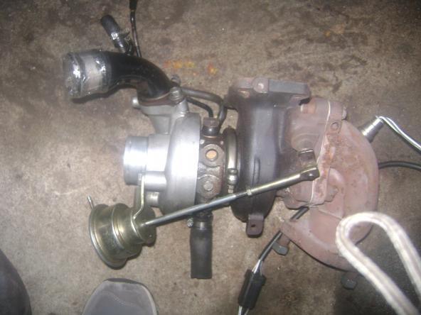

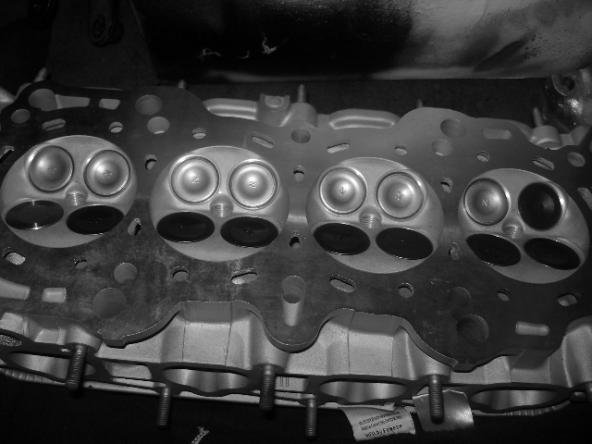

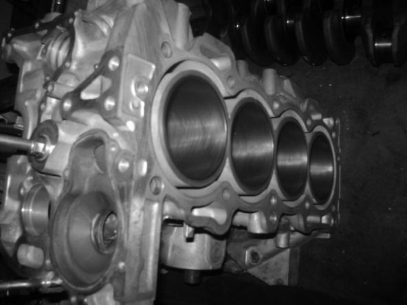

stock block all brand new oem.

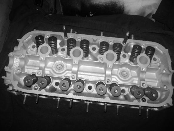

3 angle valve job a couple new valves also.
bisimoto turbo cam
bisimoto 5 layer mls head gasket
dsm manifold (for a short time only)
big 16g completely rebuilt

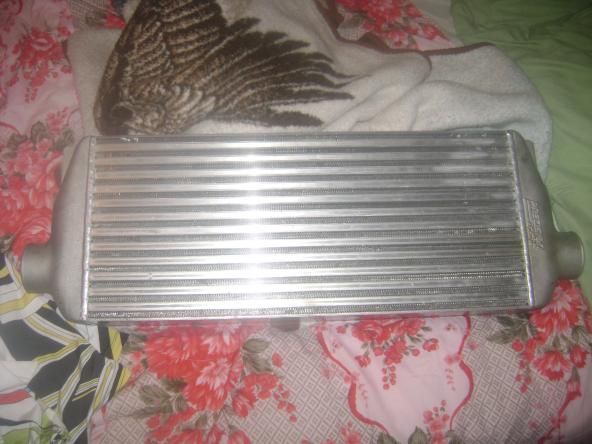

extremely large precision fmic(way to big will be downsizing if it wont fit behind bumper)
custom i.c. piping
greddy bov
full 3 inch side exit exhaust from turbo back
and soon to be lots of tunning with crome with a p75 ecu
edit: injectors dsm 450cc's for now.

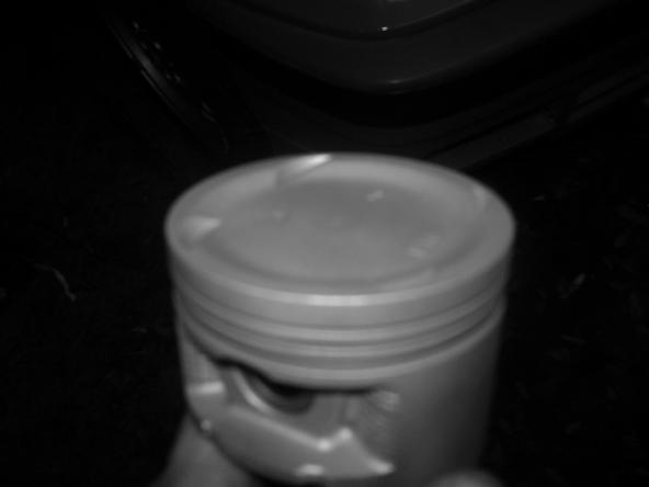

any opinions are great even haters. and if u feel i am doing something wrong then tell me please i am always willing to try to do something better. but for now this is a budget build i plan on rebuilding the a6 that is in the car currently but it will have pistons and rods in it. it may get sent to bisimoto.. i wish.... but that is another project for another time.
