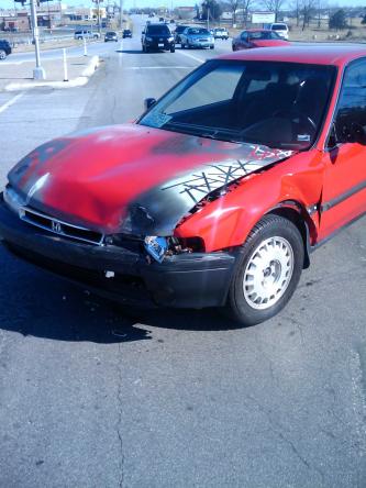

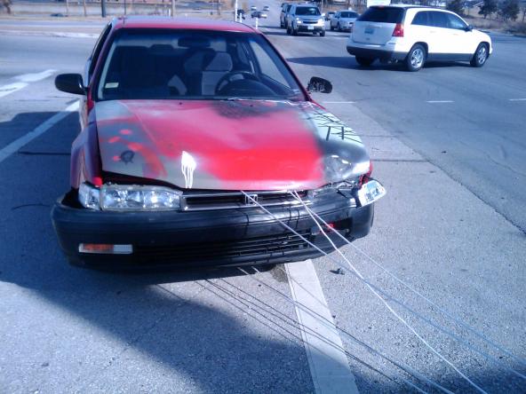

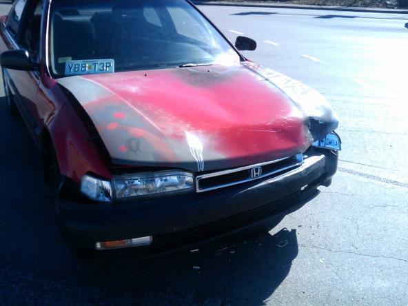

    that cuts off the fuel when you get in a wreck? I dont know if it has one or if one of my grounds got knocked off or something because now it wont do anything when the key is turned on. Some queef nugget pulled out in front of me and I t-boned him, he didnt have insurance, I had liability only since its just my dd. So Im left to fix this myself. I've started to disassemble it a little bit, the rad support is pushed back into the alternator. Any input is greatly apreciated.

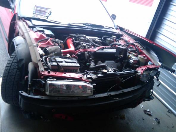

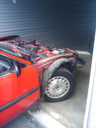

                  Thats exactly what it was, thanks man! Heres some pics of the tear down, If you notice the frame is buckled up top on the pass side. Ive got it torn down to the core support, next stop is the frame shop. I think it can be fixed, Im gonna try at least
