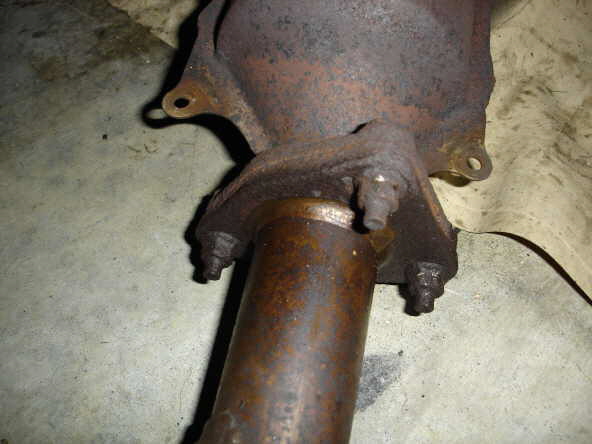

I need a mechanic to remove the exhaust. The nuts and bolts are rusted so they will have to be heated up and removed or cut with a torch. I have tried everything from saws, chisels, portable torches and nothing works. At this point I'm willing to pay someone to do it and get it over with. If anyon wants the job just pm your contact info or leave in this tread. I will call you ASAP. Thank you.

drop all the hangers and pull the exhaust out from under the car, and have at it with a hacksaw... cut the nuts (and studs) off and separate it with a sledgehammer, then hammer out the remainder of the studs (where applicable) and use regular bolts when reassembling...
dropping the exhaust gives you tons of room to do whatever you feel is necessary to separate it...
I tried sawing them. I just don't have the leverage being underneath the car. I brought one of those propane torches from Autozone and it won't get hot enough. I thought about renting a professional torch at Home Depot, but I would not know what to buy. Believe me I've tried everything and my only option is just to pay someone to do it.
thats why i suggested dropping all the hangers. drop the hangers and use a hacksaw and it will be much much much easier.

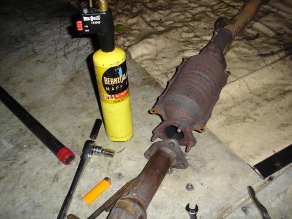

VISE-GRIP makes a damaged nut/bolt extractor set I think they call Bolt-Grip Sockets, sold at any advance/auto zone. they are tapering spiral cut on the inside for all sizes and are square drive. These things have saved me on exhaust every time- it's crazy. Just find the smallest size that almost fits and hammer it on to the nut- then you can use a breaker bar in the drive or a wrench around the outside hex flats.. If they slip, they grip tighter. They pay for themselves every time I open the case. Hacksaws and cutoff wheels are your friend too, good luck.
