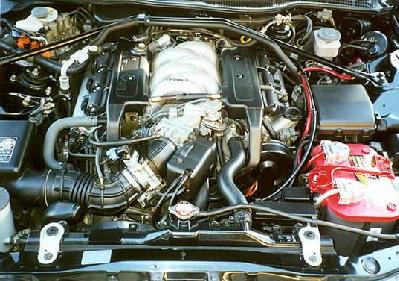

this is what a J32 Type S motor looks like in a Civic...we should have no problem fitting one in our CB's.

umm no first of all that is going to take a whole lot of fabricating because the g2 legend engine is longitude mounted so that means your going to to have to fab all the mounts. then when your finished your not going to have alot of room for the cooling system, which if you know g2 legends skimping on cooling very easily leads to blown headgasket. those motors love to blow head gaskets. (just go to acura-legend.com and do a search for bhg in the g2 section and you'll see what i mean) by the time your done shoveling all kinds of money into your cb7 trying to be different, you could have had a kickass h22 swap and probably a nice turbo to go with it. your f22 motor has more after market support then the c32, g1 to the g1 rl is still a doing a grass roots kind of tunning more reminiscent of early civic tunning in the early 90's. now that j32 swap might be a whole lot more feasible because it's already transverse, we were going to see if you could shoehorn that into a g1 legend but so far no one has enough $$$ to try.

If a C series will fit in a legend, so will a J series. It is smaller and lighter than the C series.
Originally posted by owequititIf a C series will fit in a legend, so will a J series. It is smaller and lighter than the C series.
it would only fit in a g1 not a g2. g1 is transverse g2 is longitude and no it is not rwd. the j series is not smaller it is about the same size as a c27a1 it will fit but the front has a very large motor mount that would be very hard to fab in a g1.
