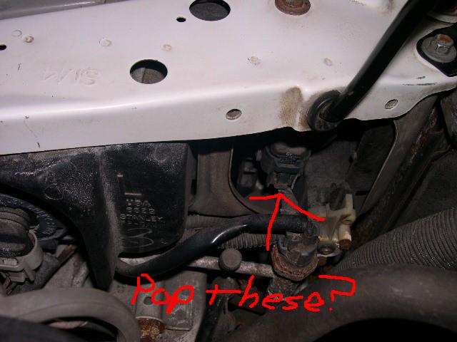

Anyway...I was gonna kinda ask a question similar to the first guy. I know that I don't need to remove the headlight to put the new bulbs in...but how do i replace them? In my owners manual they just happened to do every light but the headlight. Here's a pic... It's the drivers' side. I think i can do that one...but on the passenger side there's the battery and stuff in the way. HELP!

what way do I twist them? I just want to make sure so I'm not tightening them...
do you need to pop something out THEN turn them?Last edited by ProjectCB7; 12-31-2003, 10:42 PM.+ '93 Accord EX - CB7 - Frost White w/ Dark Blue = teh s0ld (ilikebigbutts)
