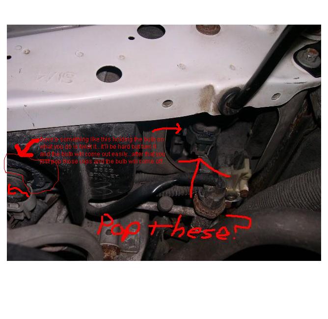

After an hour of tinkering we've got it. The little circle thing that adjusts around the light is obviously very hard to work with. So, what you need is a screwdriver...flat head, and a hammer. What you do is pop the tab out and disconnect the hook up. Then insert the screwdriver into the little area inside the rund thing. Tap on the top of the screwdriver untill it moves the circle thing. Line it up untill the light will pop out. Replace. Do same steps backwards.
