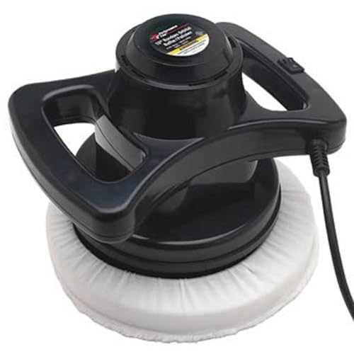

I help ya a little more, I dont want you to buy just any random orbital.
Whatever you do, dont buy one of these:
All they do is hurt your hands and back lol. They cant remove swirls, and really dont even spread wax very well.
Try to get one of these: http://www.autogeek.net/random-orbit...isher-kit.html http://www.autogeek.net/porter-cable-7424xp.html
Mess around on that website. but wear a helmet. It might blow your mind.
