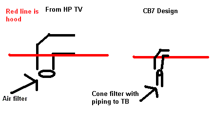

                      Man a CB7 with a scoop, that would be awesome! I think the CB7 would benifit from a hood scoop. I saw on Horsepower TV they had some custom car with two engines that had a really functional hood scoop(s) - its hard to explain but Ill try. There was a really big hole in the hood, then attached to the top of the engine was a big duct that would stick out of the hole in the hood. At the bottom of this duct (it was like a 90 degree duct) was a circular air filter. I attached a ghetto diagram of what im trying to describe. I think if you built a much smaller duct, and had a regular cone air filter, it would be an excellent design. A lot of people just have scoops that pour cold air into the engine bay, but its not channeled anywhere. With this type of design, you get cold intake air, and a cooler engine bay.

                        Right, between the scoop and the airbox/intake you would need some sort of seal between the hood and the top of the air box.
                        Nothing major.
                        They have a few WRX style scoops on sale through Ebay and such.
                        My only concern is since they're fiberglass, first off, getting a nice good bond to the hood.
                        Secondly, since the hood flexes so much, either cracking the scoop or the paint around whatever bonding material/filler you used to mount it.
                        I'm not a body guy, so if somebody can shed light, that would be rad.

                          Well with the HP TV hood scoop, they just had a hole in the hood. The scoop was actually mounted to the engine, so when you lifted the hood, the scoop was still there. That way you don't have to worry about bonding things, just get out the jigsaw .

                            The scoop mounted directly to the engine is called a shaker scoop or shaker hood.
                            Old hot rod terms.
