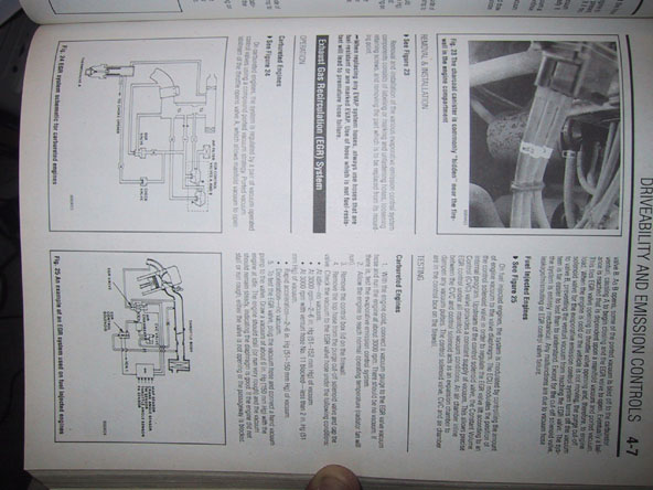

                  EGR components are generally simple to work on and easy to access.

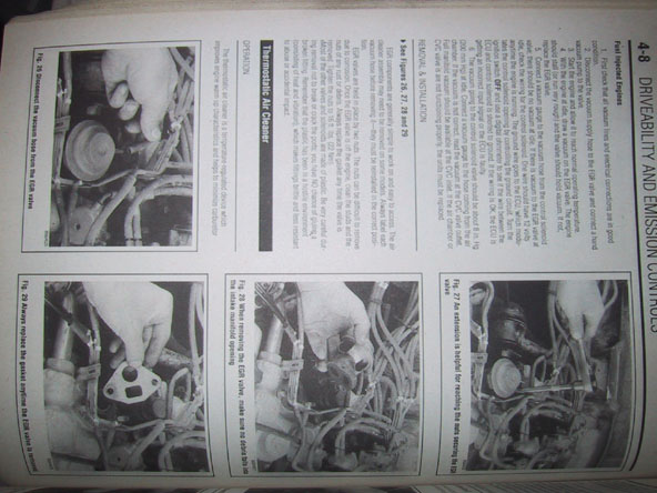

                  Taken from a chiltons manual, which gives procedure for testing.

                    And page 2

                      The Prgrammed Fuel Injection (PGM-FI) System is a fully electronic...blahblah..The ECU is given responsibility for control of...blahblah..alternator control as well as EGR function and canister purge cycles.Troubleshooting is generally based on symptom diagnosis and stored fault codes, if any.
                      Ok stop..hammer time. No. It says if theres an egr problem is would be reported by the ecu. Did you pull any fault codes? Wouldn't that be the best way to figure out if your egr is faulty?
                      EGR Valve Lift Sensor - The ecu regulates the function of the EGR valve through the EGR control solenoid. The lift sensor translates the movement of the EGR shaft into an electric signal which is sent back to the ecu. The control unit compares this signal to preprogrammed values for optimum function. The sensor is located on the EGR valve.
                      It seems entirely logical to me that if the ecu is not spitting out egr fault codes, there is no fault with the egr.
