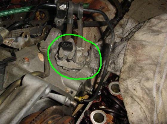

oh yeah its under the thermostat and it has a gray plug on top if it and the two pipes. right i saw it today but i wasn't sure that it was it.

the speed sensor has nothing to do with the tranny going out or anything, so i dont know where the hell you heard that.. it just means the speed sensor is going out and you should replace it..
as far as the solenoids, its not a part youll be able to find anywhere but the dealer.. you might be able to hit up a junkyard and get em also.. just ask around the board if anyone has a junked auto tranny and see if you can buy them off of them..
