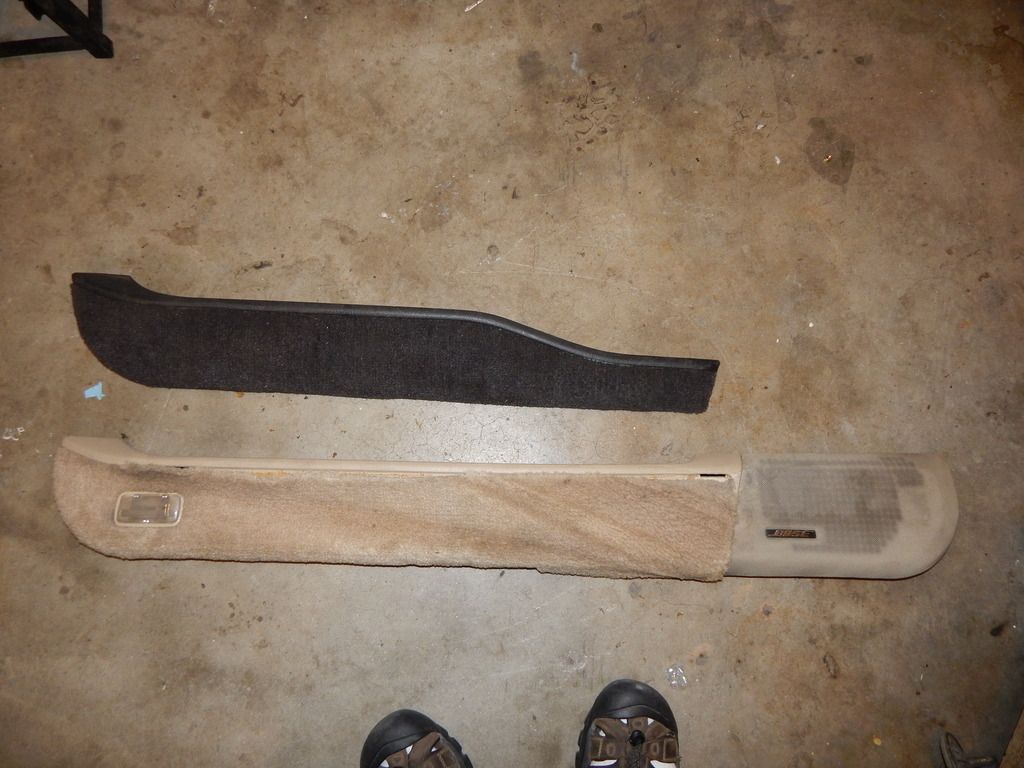

1. Fully disassemble both door panels, you will end up with the 5 pictures below
Door Pockets
Door Handles
Black Door Panel
Tan Door Panel
Tan Leather Insert
If you pay close attention between the 2 door panels you will notice how different they are.
Door Pockets
Door Handles
Black Door Panel
Tan Door Panel
Tan Leather Insert
