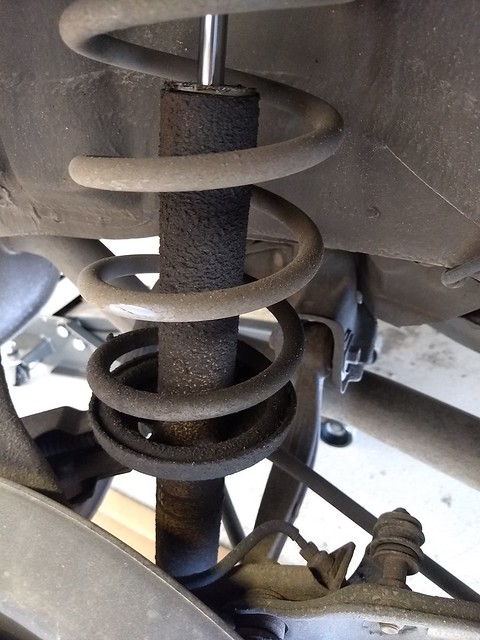

Both rear Koni's blew... I don't know if it was because of the springs which sagged pretty bad (I don't think H&R optimized these for the wagon) or if at least one was defective. I do remember one of them had some oil around the seal when I installed them.
I wasn't too beat up about it. Eventually I'll get around to sending them back to be rebuilt. I was always curious about the KYB AGX shocks since they seem fairly comparable to the Koni Yellow's. I definitely like the adjustment knob on the shock body a lot better. I went ahead and installed factory springs back in it too to get rid of the sagging. The exhaust hasn't scraped on anything since!
