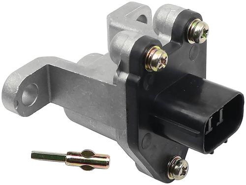

Yes the sensor is universal. It has a plug on top and bolts holding it to the rest of the mechanism. It is universal between A/T and M/T and not only that but the 9293 version fits on preludes, accords, civics, and a ton of other Hondas.
92-93 looks like this^

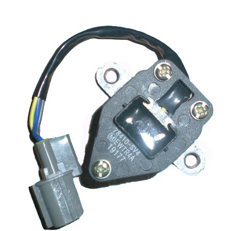

90-91 looks like this^
So it is more year specific than A/T or M/T specific for as far as the sensor itself goes.
Yes, but the other way around the harness might not reach. Using a 9091 harness on a 9293 sensor might be a real stretch unless you modify the wiring loom a bit.Originally posted by domesticated View PostI plugged my 93 auto harness into a 91 manual sensor when I went 5 speed. 5k miles and no problems yet.Last edited by wildBill83; 07-14-2013, 08:51 PM.1993 SE Coupe MRT - 1992 LX Sedan MRT
