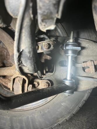

Sorry for the late reply. There posted, but if there shit tell me ill go retake them. dont look at the muffler rust tho....Originally posted by UnicornHondaSE View PostWould love to see pics of the final result! My bro's is a '91 SE so I think it has a sway bar. Any idea on the size of OEM vs the ST?
Also if your accord does have a sway bar, the stock is 14mm and the st suspensions is 21mm. It was the first mod i did on my accord, Its def worth the 200 bucks. If you decide to buy it hmu with questions on installing it. I spent almost 3 hours tryna understand the instructions lmao.Originally posted by UnicornHondaSE View PostWould love to see pics of the final result! My bro's is a '91 SE so I think it has a sway bar. Any idea on the size of OEM vs the ST?
The bar has like a milimeter of clearance,i dont know if its becuase of the exhaust being rusted af and bending or if its the actual sway bar. But i saw that the sway bar is supposed to be able to support up to a 3 inch so idk. But when i first installed it, It def made the car feel alot more stable and connected. But I havent really have gotten a good test on like curvy roads nd such. But when i do ill say how it feels.Originally posted by UnicornHondaSE View PostAwesome! Thanks, the pics are fine, but it looks like the bar is touching the exhaust pipe. Probably only the angle of the photo
