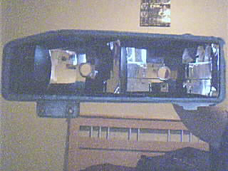

    For me i used scoth painters tape to mask off the parts i didnt want painted Then i used alcohol to clean off the areas i was going to paint and went off and bought a high temp spray can which could be found at auto zone the paint is for high temperature so it can withstand the heat of the lights.Flat balck or glossy flat black was my desition and mine came out fine take a look its kind of blurry though and its without the glass i needed the glue but if you need pics of the finished product just let me know
