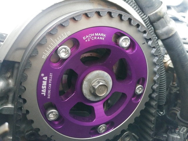

          Well, this evening I was putting a cam seal in the wife's CD so I put the cam gear I have linked in the previous post on, curious to see if it fit and I would get another one for the CB. It fit on the cam perfect and all looked to be well, until I was installing the belt and spun the engine over by hand setting the tension of the belt. The belt started walking off the front of the pulley, I wanted to see how far it would go, so I finished tensioning the belt and started it up. It walked about a cm off the face of the pulley and stayed there. Any ideas what I can do about this?I took pics but need a new hosting site, wish we could just upload them straight to here.

              I think you're misunderstanding what I'm saying about the belt walking. This is the 2 pulleys side by side face down. As you can see the center hole that rides on the shaft sits deeper toward the engine on the stock pulley, making the outer ring sit further away from the engine.
              So when I put the belt on the cam pulley, the belt sat closer toward the engine than on the other pulleys. So when the engine was spun over, the belt straightened itself, walking down off the gear. The pulley wasn't loose, and I have taken it off and put the stock cam gear back on.
              I don't know that this is enough to hurt anything, but I'm unhappy enough with it that I will not be running this cam gear. It is too late to send it back for a refund, and I have some extra stock gears laying around, I think I'm going to try and fabricate something.
              Under Construction​​​​​​​​
                I see what you mean. The inside depth is different. So I would not use this. You could rig something up but no need to play with fire here. It's simply not compatible.
                  Yea it's disappointing and frustrating, was marketed as fitting the F series. I guess when it comes time to assemble my cb (unless I can find a used cam gear, not holding my breath) I will have to just have the stock cam gear. I have searched like crazy, but no luck.
