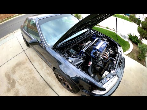

    Thought I'd share this awesome news, PLM is making 3 point strut bars for our accords. Rare to see our chassis receiving love from manufacturers. I placed my preorder and got to chat with them, apparently this week they will have it fully manufactured and the price will go up so take advantage now of the cheaper price while you can.

        It looks cool! Really cool! But ahh don't know about this. It's the opposite of every other 3-point bar I've seen which have the long bar on the right and short on the left, so that the part that bolts into the ....... wiper arm part doesn't conflict / hit the wiper motor unit. I'm sure it probably works but .......i dunno.....
          Damn, I didn’t think of that, once I get it I will update this post.

            Keep in mind the PLM photos posted were just renders, so the final product could easily look a bit different. But am I alone in thinking billet aluminum parts just look tacky as hell? I feel like this is definitely a phase in tuning culture. Makes me sad that ESP went to shit, because theirs was a decent looking strut bar. I wasn't crazy about the square tubing, but at least it wasn't a visual distraction when you open the hood. And I prefer a welded one-piece brace. I'm going to 'settle' for the two-point Ultra Racing bar just to have one that doesn't look out of place. At least until I start welding (hopefully in the next couple years), so I can make my own parts exactly how I want them...

              I considered going the PLM route, but even when my GF saw it online she said ew, then saw the price and said ew lol. So I'm working on designing a single 2 point with CF tubing. Should be around 250-350 for the front and probably 50 less for the rear.
