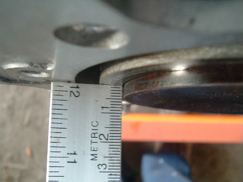

                    bad news .......h22 crank,h22 rods 4g63 1st gen piston aint gonna work
                    pistons out the block deck 4mm
                    piston.....120
                    h22 rod and crank.....who knows
                    headgasket ........80 to 120
                    machine work for me was 14 bux.....to mill the wrist pin hole in the piston
                    could get up in some money might as well buy some
                    not bashing cuz i luv the concept or i wouldnt have tried it but for now i gotta leave it alone .....maybe
                    hatchninja exratedaccord much props if you chose to go foward with it ill be gald to helpkeep in touch and look to meeting you guys next time im in that area

                      we knew about the 4mm difference . . . someone suggested a thick HG but that would drop the CR too . . .

                          but by the time you do the machine work to the pistons buy the pistons and buy the gasket you could just about buy a set of SPR pistons and all you gotta do is have the pistons pressed on the rods to each his own and like i said it was and is a great idea and i love it simply because its doing something off the wall but it gets real involved and can run the dollar signs way up just my 2 cents and ive already had the work done on an old piston so i know how much itll cost me to get it done
