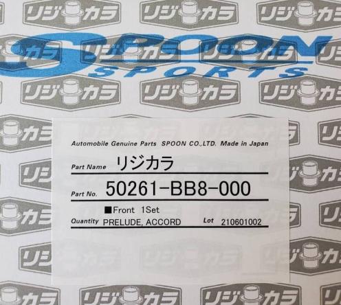

      Also I had grabbed a P28 one day while I was at local yard. It was an 1995 Civic EX sedan with a p28..considering no one grabbed it right away I snagged it. In June '21 I sent it off to phearable for the HondataS300 install.
      Also picked up a set of Spoon Rigid collars and yes, you can definitely tell a difference.
