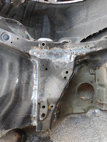

The first picture above is looking up into the right rear wheel well/spring-shock tower. The second picture is looking down on that same body section from above with the rear shelf portion removed (base of the C pillar is at the top of the picture). Everywhere I can, I intend to cut the spot welds and split existing seams. Similar to what I did the first time, I cut through just one surface of the joint; on the car I work from the outside to remove the bad pieces and on the donor pieces I work from the inside to get the pieces I need leaving the flange that was originally spot welded intact so that I can re-spot weld them.

That's why I said that's the tricky part. I should have cut the pillar higher up on this trial section to see how it is put together. Might require taking the outer layer off to allow the inner layer to be spliced, then replace the outer layer.
4/25/2021: Working to split the wheel housing from the frame section.

Did some more dissecting. Removed the cross brace section. If I'm going to go forward with this repair, I'm going to need a rust free shell to get these large sections from - any help in locating one would be appreciated.
