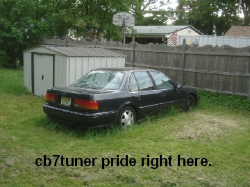

                          Thanks for looking, Dirty pic for the hell of it...
                            lovin that color!
