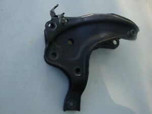

          Oh get to now. I dont actually remove the rear mount itself. Just the tranny from it.
            The top right portion goes to the body mount (on the car). The far left bolts go all the way through and into the transmission but the upper hole is into a engine "tab" that jets out and fits into this mount.
            So technically speaking I think it's the 3 bolts from the bottom that are trans only. Hope this helps.
