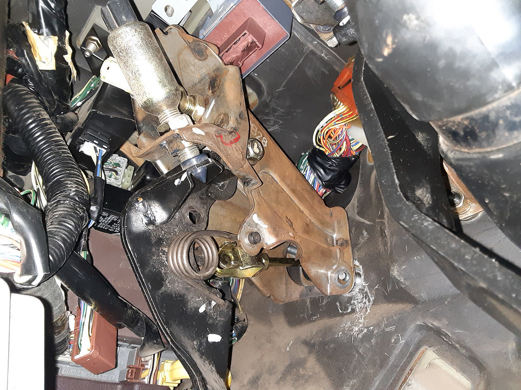

I seem to have run into a problem installing the clutch pedal I grabbed from a junkyard CB: it doesn't fit in my footwell, with the main relay and some other components in the way. The black box to the left (blue and black wires going into it) in this first photo is also keeping the pedal bracket from sitting right, and I had to unbolt what I assume is the cruise control computer as well just to get it sort-of up in there. Might there have been different pedals from year to year, or between trim levels? Mine is a '93 EX. I also noticed that I don't have the firewall spacers to bridge the foam gap.
I think I've figured out the pedal fitment. I went to look at a junkyard CB, and the main relay was simply rotated 180* from mine, if I just unbolt the black box to slip the bracket underneath it over those bolts. Found something else interesting, though: the clutch pedal I pulled has two switches on it, but this second car I looked at (a DX, if I remember right) instead just had a bolt and locknut serving as a stopper in one of the spots. I grabbed it, and I'll look into what that switch is before deciding which to use. It reads when the pedal is completely released. Not sure why that's valuable information, but I want to do this properly.

Good find!!!
I have seen that switch also. It seems that my rubber stopper disintegrated a long time ago for that switch and it is never engaged. I am thinking it might be the switch for the cruise control interrupt circuit? I somehow thought the clutch switch for start would be the same as the cruise interrupt, but this may mean that they are different switches.
Ah, cruise control, that makes sense. Thanks, guys. I definitely want to keep that switch and figure out the wiring, then.
I'm actually not having too bad a time with the pedal swap. At the junkyard, it was a massive pain to remove the pedals, but when I got to working in my own car, even the spring on the brake pedal wasn't giving me problems! Easy off, easy on. Driver's seat still installed, even. Having a pick set, using the one with the hook on the end really helped.
I do believe there are indeed two separate signal switches on the clutch. Of course the one at the bottom is your clutch interlock but I recall my cruise control switch being at the top of the pedal throw. But all creature comforts have been missing from my car for nearly a decade now.IG: H2wagon
