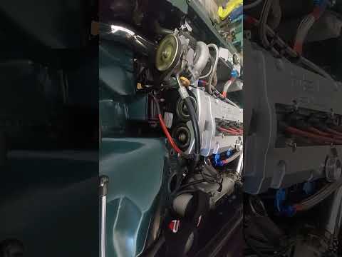

Meanwhile, I'd say this is the most nervous start of my life.
https://youtu.be/z2T7DaRZ3xk
Sounds decent for a first startup. Things will slowly quite down a bit as it gets some run time on the motor.

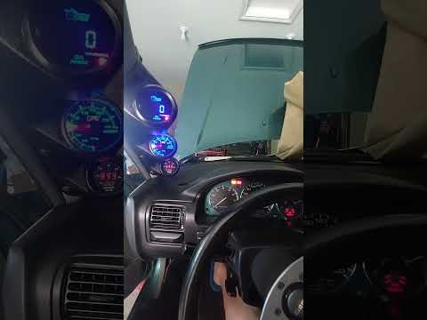

Soooo got some guages hooked up and there's obviously an increase in oil pressure. But that is expected with the balance shaft delete kit.
New
Ignore the A/F as there's no intercooler on it. I definitely notice the vibration in the cab of the car but to touch the engine it's fine at idle. The car is also on jack stands. But I can tell the engine sounds smoother and cleaner. "Newer".
