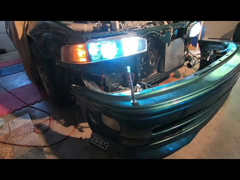

Now I have to put the whole front end together which takes a long time...
